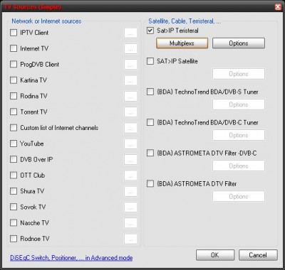

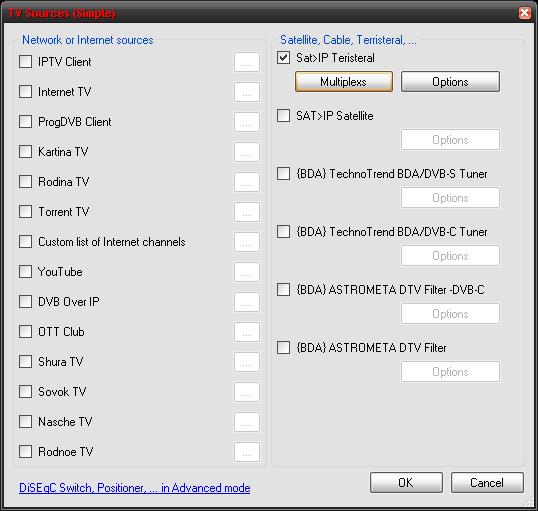

There is no option for the SAT>IP for DVB-C? Today I would have some time to test this. The screen shot from below is from the latest version 7.12.3
