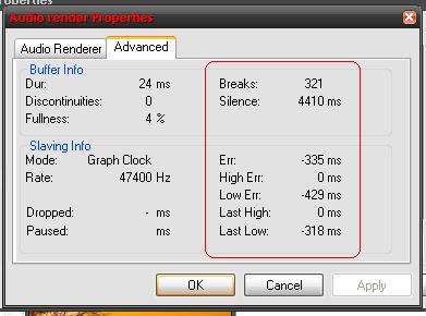

I still have problems with the audio from time to time after using the timeshift controls. :(
As it can be seen from the attached screen shoot the problems start from some drops. Any idea how to fix this? Tried different audio renders, codecs but still happens.

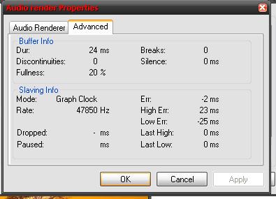

#43
When it works well it looks like this.
The stream that is in memory is not broken because if moving again the playback point it is better. Could it be that when the playback starts from the wrong frame?

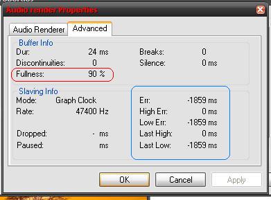

#44
Looks like there is another situation when there are no losses but the audio goes out of sync after using the controls.
In the screen shot attached the blue rectangle indicates a value that freezes (usually it is continuously changing) when the blue rectangle indicates the audio delay.
Note: When this situation happens the audio and video return by themselves in sync after a few minutes of playback. But only in this case.
