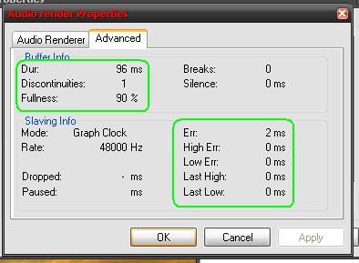

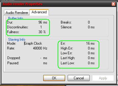

On live tv everything is fine as it can be seen in the screen shot:
After pressing pause and again pause a few minutes later everything is ok.

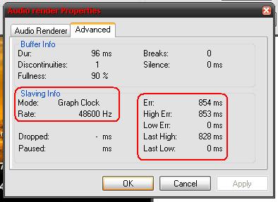

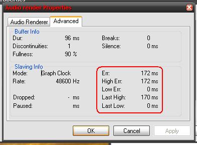

After using the slider is starting to go slowly out of sync:
When the rewind button is used it goes much more out of sync:

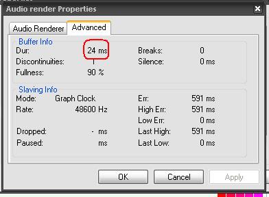

The screen shot after using pause mode:
(I could not attach it in the previous post :( )
From what I see the audio video sync problems start when that Rate is not 48000Hz any more.
There is any way you can influence this?

- and there are other channels where there are frequent problems when changing the timeshift play position. What I see different to these channels is the indicated parameter which changes frequently between 24 and 96ms
