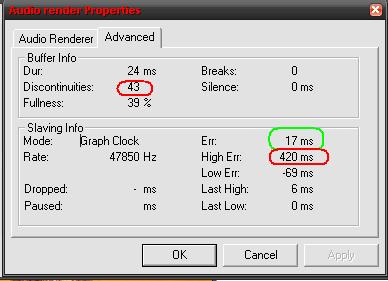

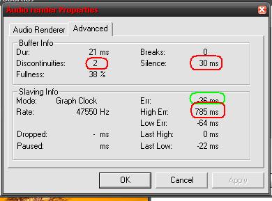

Here are the data for HD H264 channel with mp2 audio:

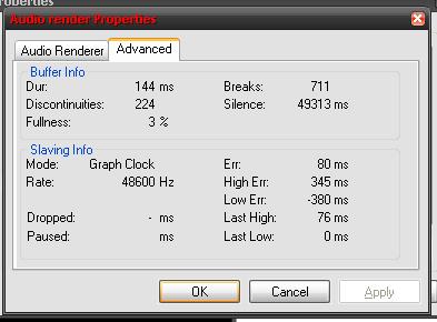

HD H264 with AC3 audio:
PS: It seem that you developed the code around these to codecs and for this reason I only got strange results with the other audio codecs. At least I have a working solution now. Thank you!

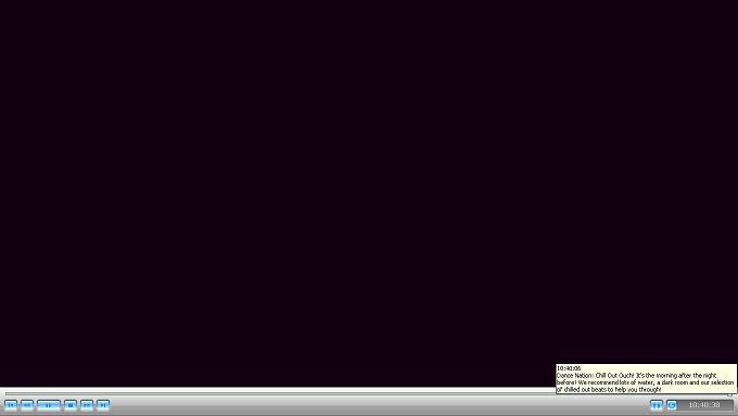

Thee is a small interface bug that can be annoying when in full screen and wanting to change the timeshift position. The EPG tooltip appears over the slider and is a bit tricky to drag it.
Of course I could just disable the tooltips from settings but that setting doesn't seem to be working any more
