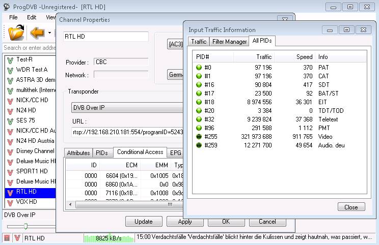

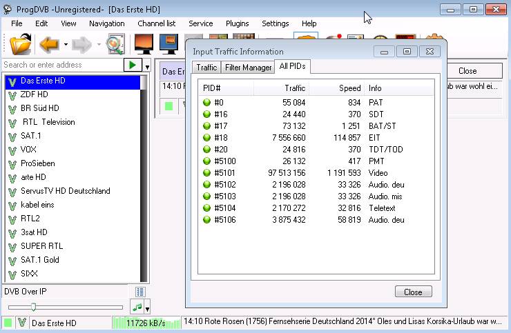

1) About Pids, you are rigth. I attach two screenshots of the window "Traffic information" that shows pids. Please, see images of FTA and non-FTA channels. As you can view, ECM pids aren't in the TS. Yes, this is a trouble. Nevertheless, using SAT>IP "pid commands" you can add any pid that you like. You only need to use correct commands (and the box do it). But, first we need the correct graph running to process packets. After that, the only task to do is add the pids.
