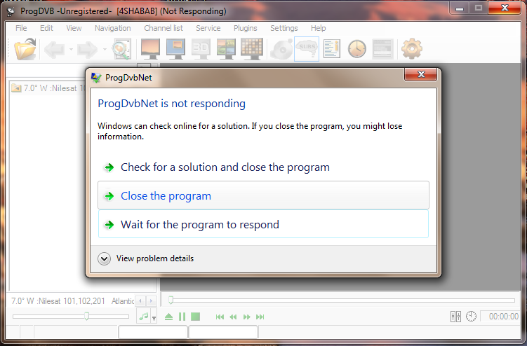

Hi
I have problem that when I chose enable cam interface the app crash
my dvb-s card is technotrend 3200 HD
thanks

#3 by Prog
I have 2-3 same reports but not have good idea :( What last good version of ProgDVB for you?
ps:Same problem in last prerelease?

#4 by A.S
thanks fo your reply
I don't Know which is the good version of progdvb for me because I've purchased an irdeto card Two weeks ago.
I've tried the last prerelease and the same problem happen

#5 by Prog
Try some 6.6x or 6.5x ProgDVB.

#6 by A.S
I've tried 6.6 and it not crash but the latest version better than 6.6 :)

#7 by A.S
still a same problem in the latest version :cry:

#8 by A.S
I've found a way to run the app.by uncheck set last channel in the startup settings.

#9 by Prog
Hm. ProgDVB set first channel to fast? Do you have any command line commands?

#10 by A.S
No I don't have
