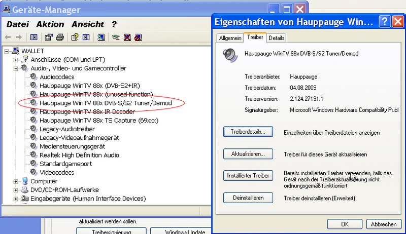

Device "Hauppauge WinTV 88x DVB-SS2"

Verified the Card with Hauppauges WinTV7 - worked (picture and sound).
Tried various restarts of ProgDVB (error reports attached ProgDVB6.85.3Pro.exe_Crashes.zip, BDA Driver 2.38)

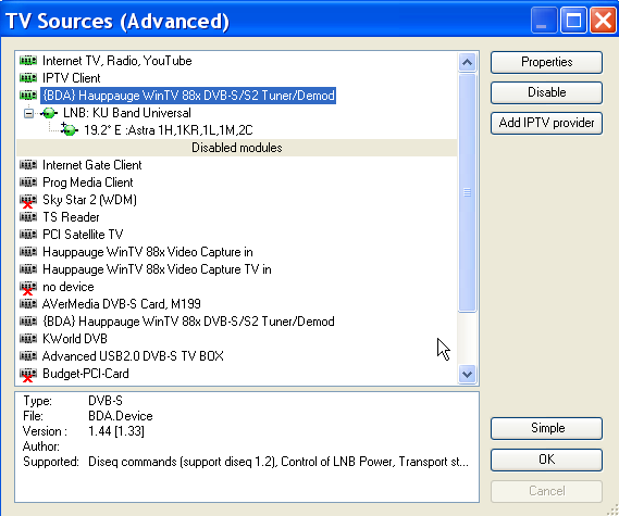

Remembered that I had an previous backup from Prog DVB BDA.Device (1.44). Copied the old version into the modules Directory.
Now ProgDVB starts (BDAv1.44.png).
Could you please check your BDA Driver 2.38?
