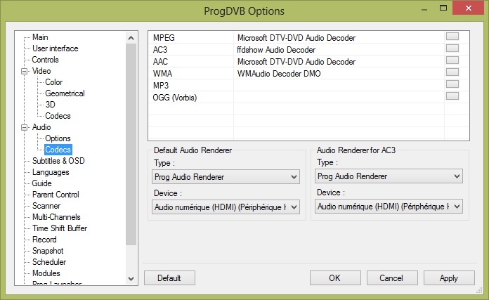

I found a temporary solution for the evening.
I choosed "Reset all settings" and so far ProgDVB has been able to open HD/SD/Mpg/AC3/E-AC3 channels.
Nevertheless I'm afraid to touch any of the settings because the problem could appear again.
Here are the default settings found by PorgDVB (and no I've no HDMI output ...)
Edit : Ok I modified the settings to fit my needs so far no dialog regarding the pin error appeared.
Here is the log:
