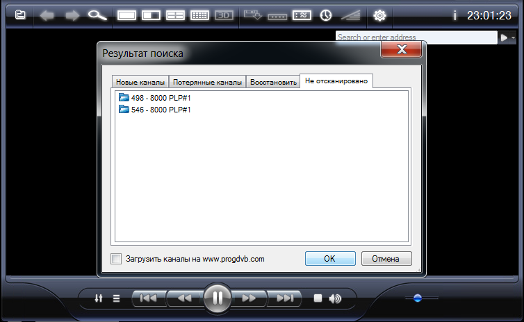

crackname, I have install final ProgDVB v. 7.28.2 now. After that I have add your final module (03-07-2019).
As before the autoscanning mode has find only one PLP>0 channel (#07) and showed it at scan results with other PLP0 channels and add it to channel list with other PLP0 channels...
Logs are attached.
By the way, I have checked the logs now, and find that while scanning the program has detected also the PLP1 channel (#02), but did not showed it at scan results and did not add it to channel list...

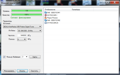

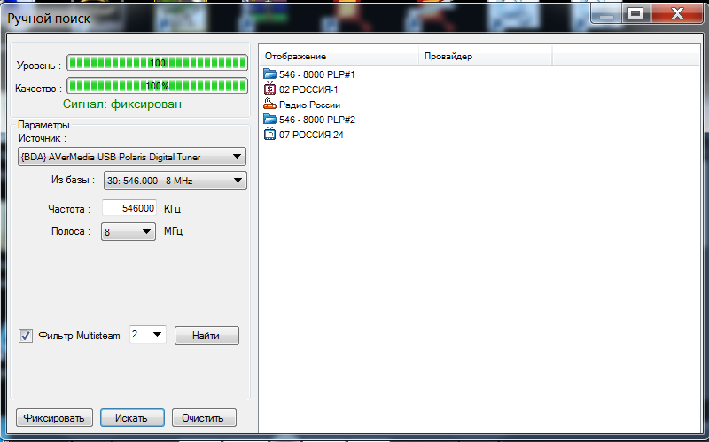

2) just find now, maybe it will helps you - when use manual scanning for PLP>0, the icon of #02 channel has "$" symbol...
Maybe the autoscanning mode detect it as pay TV channel and not shows it at scan results?!

Dear crackname, sorry to mislead you... At Manual scanning - all needed channels was detected since module ver. June 30.
Then Prog asked me to check autoscanning mode (Normal scan). So, since June 30 I have checked only autoscanning mode with new modules, all above logs are for autoscanning mode only.
In attachnment is log for autoscanning with module 03-07-2019 new. As before channel #02 not detects... If use manual scan then channel #02 will be detects as well.
So, do you need logs for manual scan?
