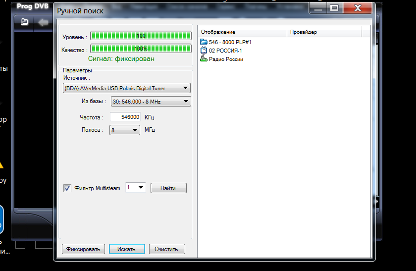

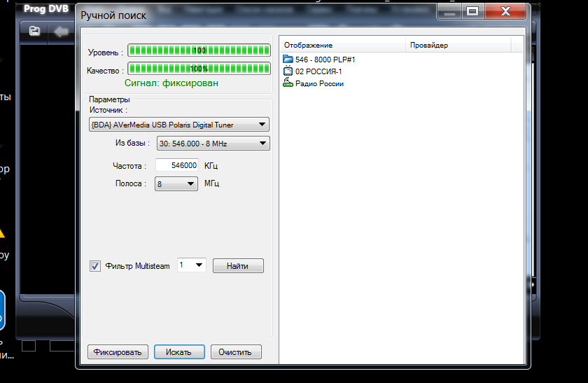

Auto scanning is not find channels with PLP>0.
Manul scanning allow to find channels with PLP>0, but its interface have no OK/Cancel buttons, see attached picture. I also tried to click the Fix button, but no result...

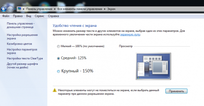

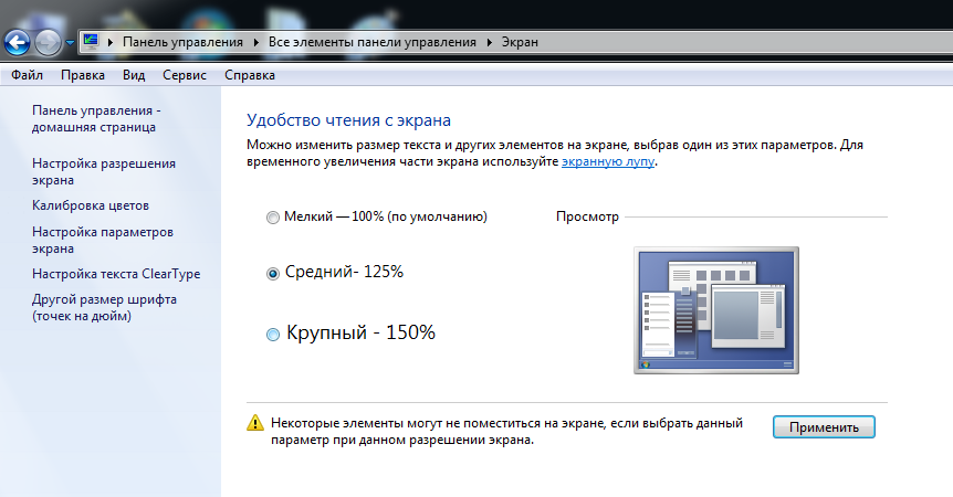

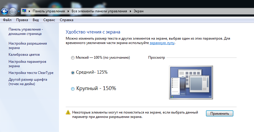

Sorry guys, I find the problem of missed OK/Cancel button: In my PC I used 125% font size, as attached.
If switch to 100% then OK/Cancel buttons will back to interface!
And I finnaly success to add PLP1 and PLP2 channels to my channel list!
Special Thanks to crackname!!!
