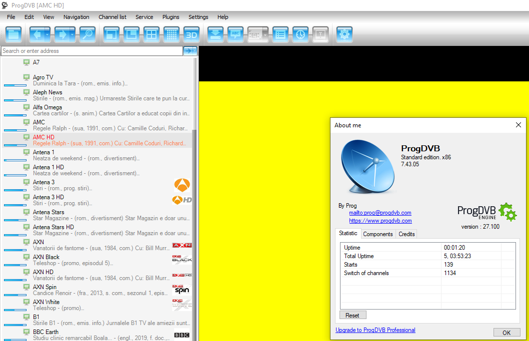

I have upgraded to ProgDVB 7.43.0 from an older version and when I switch channels, it appears a yellow or black screen. I need to restart ProgDVB and it works. But after I start switching channels the problem appears again. With the older version I did not have this problem.

#4I you sure? Check version number in about me. I have report about this problem only in some old versions. That fixes 2-3-4 versions ago.
Re: Yellow screen or black screen
#5I have attached a screenshot and the debug logs.
#6Try change video renderer for example to EVR. Do you have same problem?
#7It works ok with EVR. I had EVR Custom before. Strange it worked before with old progdvb version with EVR Custom.
