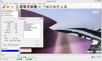

Re: 4K H265
#7Hi Prog,
Test with "c" prerelease...
Thanks, work .... but not fine for me, my GPU is too old !
Re: 4K H265
#8Any problems? I am recommend rescan channels after 7.04 installation for x265 support.
