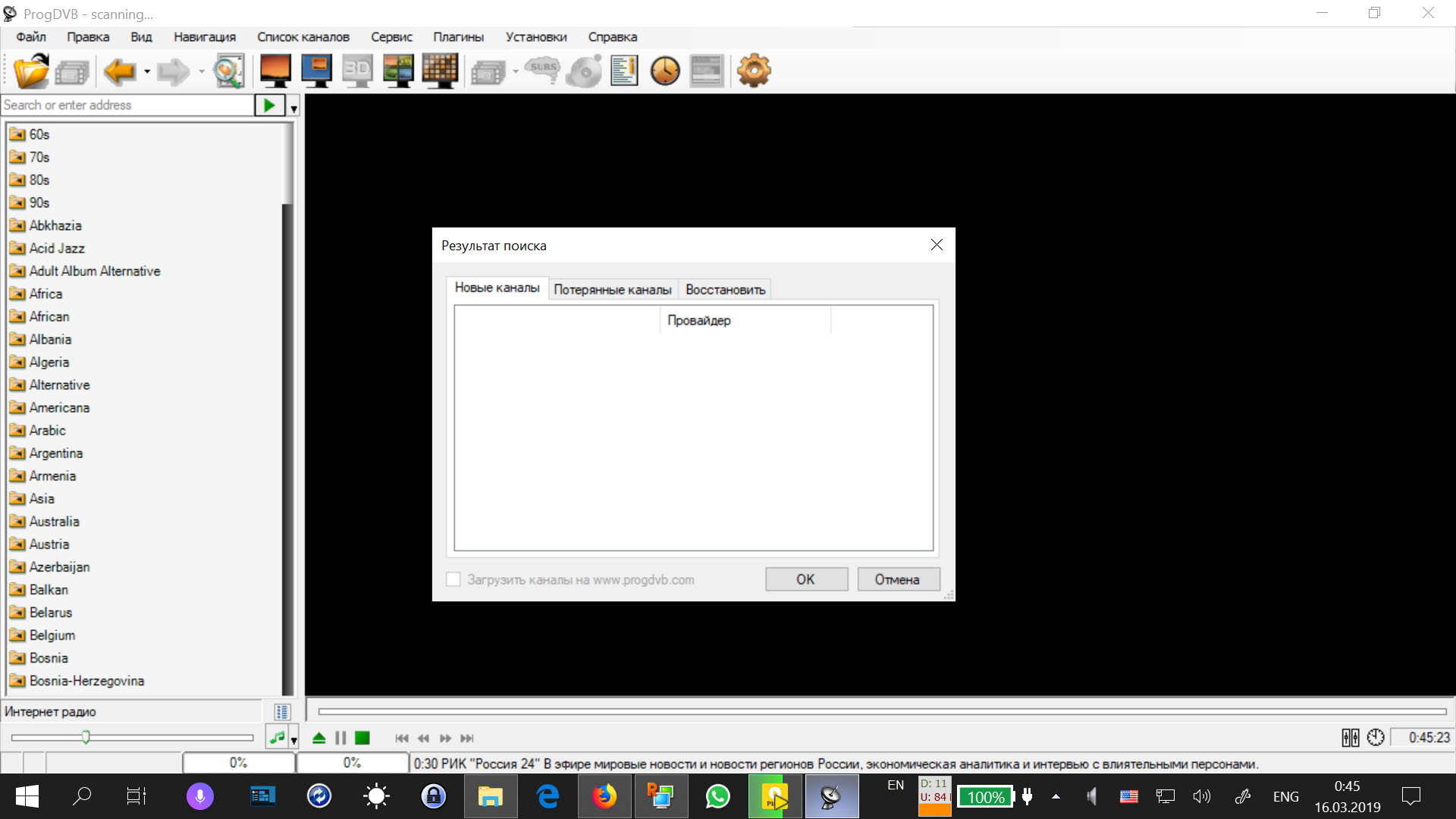

I understand correctly that each of these three files needed to be renamed to Avermedia.eBDA and in turn placed in the modules folder corresponding to the x32/x64 of the ProgDVB.
If so, then here are the test results. Unfortunately, nothing has changed - cable channels are not detected.
For each file, two tests were performed, automatic search and manual search with setting a specific frequency of the channel (multiplex) working in the official software of the Avermedia channel in my DVB-C cable network.

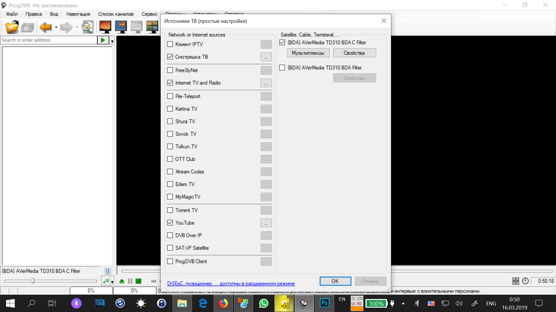

crackname wrote: Please note, that AVermedia Software Unload Totaly the DVB-T Tuner Filter before switching to DVB-C, so you should probably disable the DVB-T/T2 Filter (Module) before doing any DVB-C Scan.
As far as I understand, it should be done the same way as last time, when only the tuner cable mode is selected by tick (see download/file.php?id=3277&mode=view)

I don’t even know what to do, but nothing has changed. In the official software of Avermedia, cable channels are detected, but not in the ProgDVB. :(

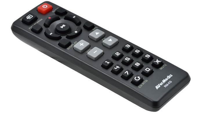

crackname wrote: Can someone try the attached module, and if you have a Remote-control; could you check if it work.
Yes, I have a remote, it is included. (See picture.)
However, I did not understand, but how to activate it at all in the ProgDVB. With the native software Avermedia it works fine.
Moreover, for the remote control to work with the native software, an agent AVerQuick.exe must be launched.

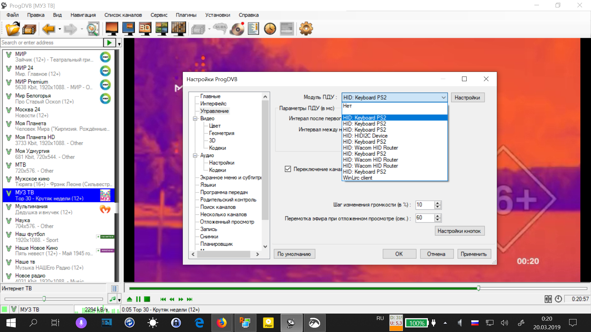

Questions
Should this agent be launched when the remote control is working with Progdvb?
What type of remote control do I need to select in the ProdDVB control settings (see screenshot).
I tried to choose a few points, but the remote did not work.
