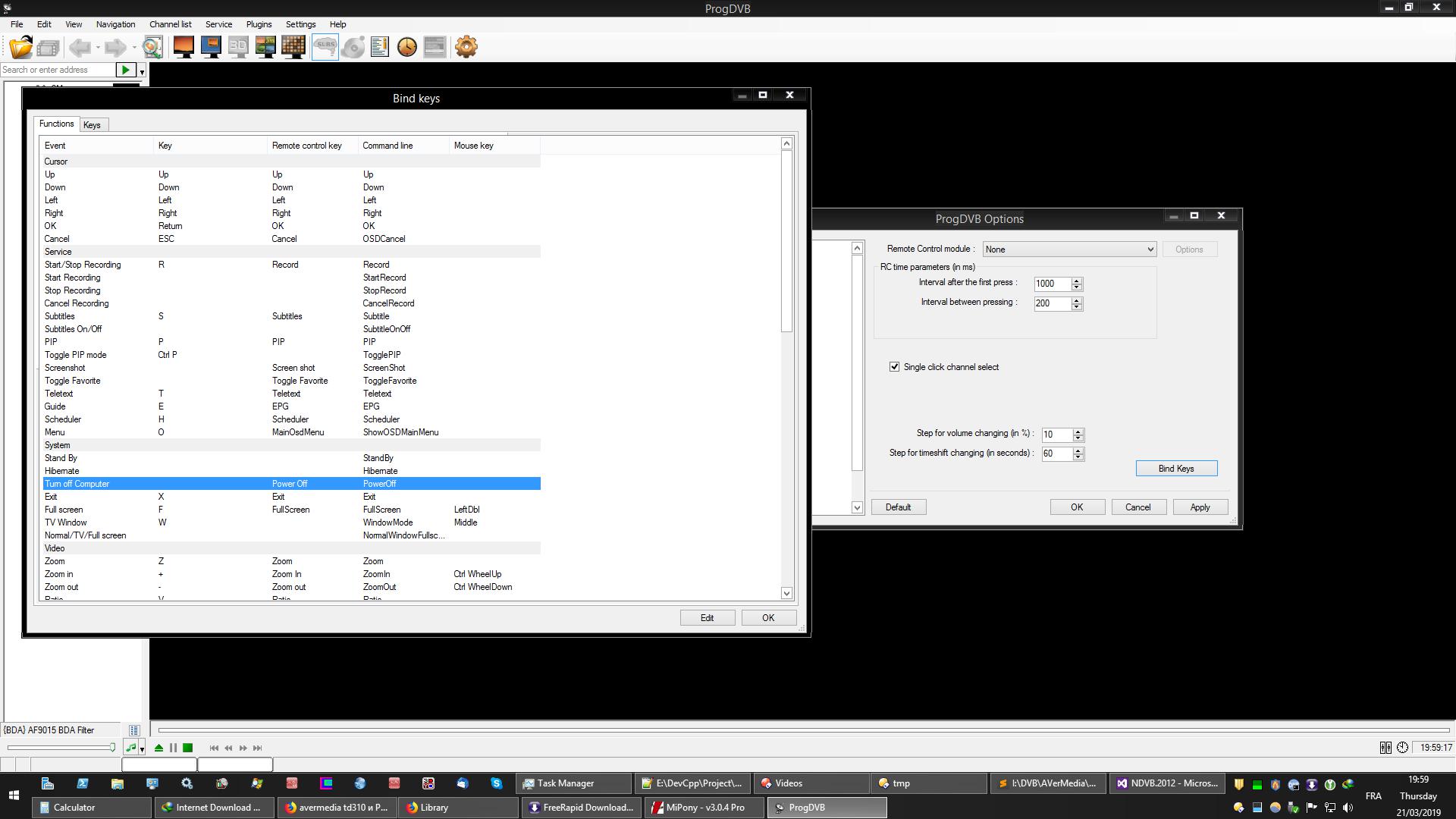

The shutdown of the computer is in what ProgDVB does when it receive a 'PowerOff' key press (See the highlighted part on the image).
So 'Recall' key is reversed with 'Mute' key. I will change that or ask Prog to change two line of code. Please reconfirm it's still does that (Please install the PreRelease it has the new code).

And also still does not find an explanation why the computer when the service is unloaded when you press the red "Power" key on the remote control shuts down. Where is it at all possible to customize?
The shutdown can be disabled on the configuration Options > Controls > Bind Keys. Just look for Power Off in "Remote control key" column, and change the key.

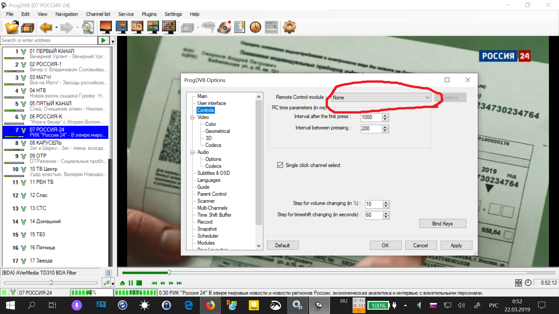

Thank! This helped to disable this feature.
Yes, I also want to understand. And why does the remote control continue to work (with the glitches described in my last post) even if the control model in the remote control model section is NO? (see screenshot) There generally what should be chosen ideally (when using the TD310)?
And the question after. Why are there identical menu items in the list of RC modules, such as "keyboard PS2", and why are they repeated? (see screenshot)

#74
NSGrid wrote: ↑
Thu Mar 21, 2019 10:00 pm
crackname wrote: The shutdown can be disabled on the configuration Options > Controls > Bind Keys. Just look for Power Off in "Remote control key" column, and change the key.
It continue to work because the code that manage it is included in the avermedia.ebda module.
The name not displayed is up to how Prog is programming his software.
For the glitches; the code try to detect key repeat, that need to be disabled in the future.
