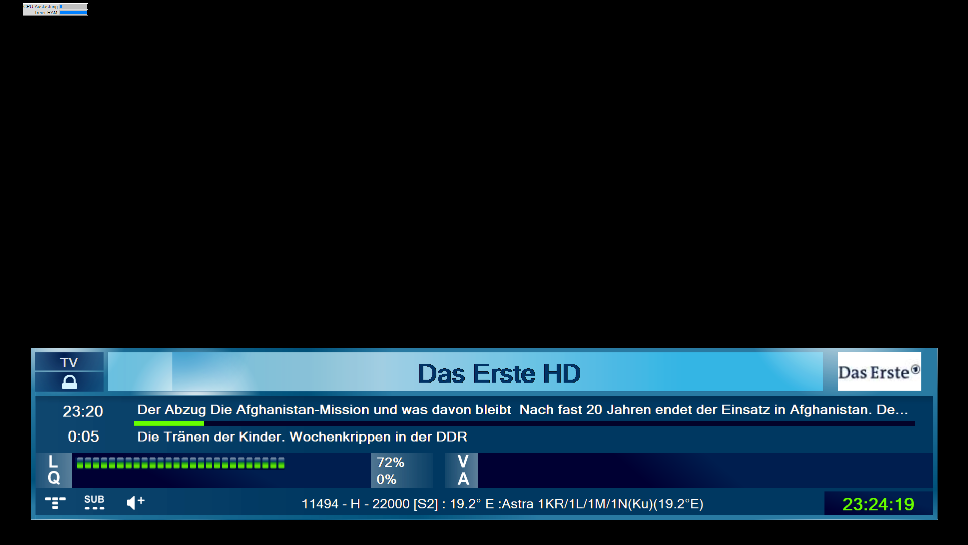

Till today cant see most of H.264 channels
#1 by Ernst1952
Having still ASTRA2 19,2° E
Since 8 pm cant see the most of the above channels, MPEG2 akk working perfect but
Das Erste HD ZDF HD arteHD L=100% Q=0%
What is that ?
I attached to whole logdir as rar and a screenshot of one of the unavailablr channels in .png,

Do you have quality = 0 before that? Try power off of PC and start again.

Some crash in BDA driver. Some drivers can stop working after crash of app (exit without normal release functions)

it startet yesterday with freezing sund and video than switching to another channel and back. It works for 1 minute and so on. Then nothing on H.264 channels (only 2 of 7 are working.. Strange :?:

Today the same. I powerd down the pc and startet new but nothing happen with H.264 chanels. Now i had to see in MPEG-Format.
Only difference is Quality is between 10 and 17%

May be some cable/lnb problem? What normal signal level for your tuner?

Normall Level 100% all other channels and yesterday alo 100% on H.264 channels. Lookin now ZDF on MPEG 100% switcinhg to HD it is only 17%
with scrambling video.

Example now
3sat L=88 Q=78 :?:
Arte L=72 Q=0 :?:
ONE L=82 Q=35 :?:
ZDF L=47 Q=0 :?:

different transponders have different signal level. this is normal (different transmitters on the satellite). But signal level total not depended from app and OS. Check cable/lnb/dish. for example I change LNB every 3-4 years, because lost signal.

After viewing a film on an MPEG chanel (about 1 1/2 hours) i switsched back to H.264 channels and all are working quality from 72% to 100%. i have done nothing (not powered down or similarl
Will today see, what is with the new version.

Signal level not depended from software version... This is only hardware part and possible depended from driver.
