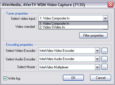

#15
AVerTV Studio 305
ProgDVB Pro 5.14.4
InterVideo Video Encoder 3.1.6.0
InterVideo Audio Encoder 3.1.6.0
When I tried to enable device, I got following error messages:
Error to get base filter
Filter not created. View log to details.
Properties dialog box:
Video Tuner is not available as video source, Composite or SVideo only.
SECAM-D also not available in the dropdown menu.
http://www.adslclub.ru/upload/data/2008 ... _18248.png
http://www.adslclub.ru/upload/data/2008 ... _65530.png
ProgDVB Pro 5.14.4

Selected StreamingTV PhTVTune
Filter PhTVTune
Pin (1) Analog Video dir = output
Pin (2) Analog Audio dir = output
-- type {0482DEE1-7817-11CF-8A03-00AA006ECB65}, sybtype {E436EB8E-524F-11CE-9F53-0020AF0BA770}
Selected Streaming Audio Cap7134 TV Audio
Filter Cap7134 TV Audio
Pin (1) TVAudio In dir = input
Pin (2) TVAudio Out dir = output
Selected Crossbar Cap7134 Crossbar
Filter Cap7134 Crossbar
Pin (1) 0: Video Tuner In dir = input
-- type {0482DDE1-7817-11CF-8A03-00AA006ECB65}, sybtype {E436EB8E-524F-11CE-9F53-0020AF0BA770}
Pin (2) 1: Video Composite In dir = input
Pin (3) 2: Video SVideo In dir = input
Pin (4) 3: Audio Tuner In dir = input
Pin (5) 4: Audio Line In dir = input
Pin (6) 5: Audio Line In dir = input
Pin (7) 0: Video Decoder Out dir = output
Pin (8) 1: Audio Decoder Out dir = output
Selected Sys. audio AVerMedia, AVerTV WDM Video Capture (7130)
Filter AVerMedia, AVerTV WDM Video Capture (7130)
Error
pMoniker->BindToObject(NULL, NULL, IID_IBaseFilter, (VOID**)&pFilter) Error to get base filter
Filter not created - AVerMedia, AVerTV WDM Video Capture (7130)
Error
-1 Filter not created. View log to details.
