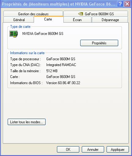

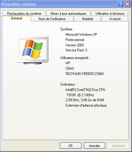

the pictures within this message shows my system configuration
please help me
thnks

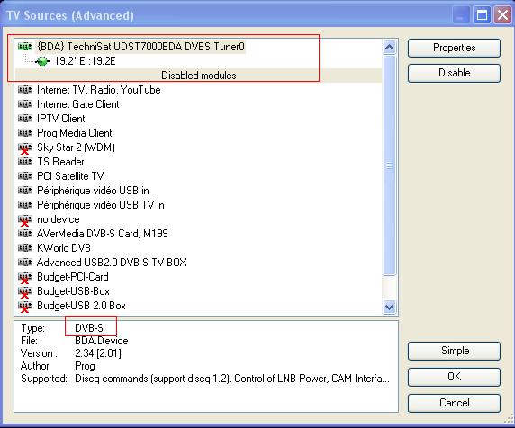

Check settings->Device options. Must be Azurewave selected.

like this?
still the same pb

by the way;
is this normal
it's showed as dvbs card
technisat UDST7000bda DVBS tuner??????
is there apb with the driver???
  • Thu May 05, 2011 12:19 pm
26174
Re: No Signal for Dvb-S2 channels using my Skystar USB2 HD C
#5 by Prog
Yes. Looks good. try Microsoft mode also.

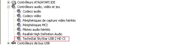

i am using this driver: soft_skystar_usb2_hd_ci_v1_3_6795
is it the same with you?
also the server4pc didn't install with it; is that normal?
are u running under windows xp sp3 also?

do you use win7 or vista?
x64 or x86?
  • Thu May 05, 2011 3:00 pm
26174
#11 by Prog
win7/x64. But I am not have reports about this problem from other users. I think you have problem with driver or driver settings.

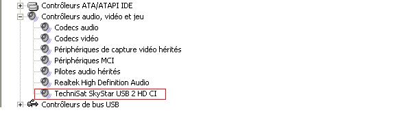

here is picture of my driver configuration
and the transponder configuration
is it wright?

I am not have ideas. This is good device for ProgDVB and I am not found problems on picture. Try reinstall driver again and start original software.
