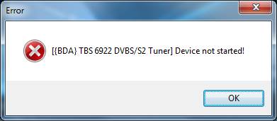

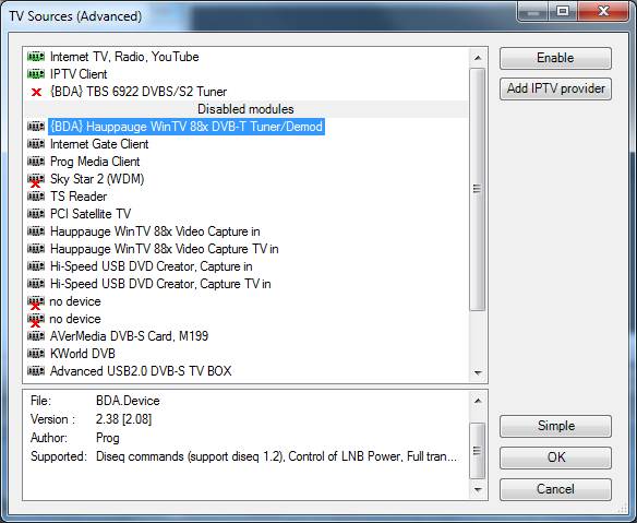

Just bought a TBS 6922 card with blindscan. It works fine in DVBdream and Mytheatre but not in ProgDVB above v5.
V5 works ok but in v6, no matter what version I try, 32bit or 64bit, on starting I get the following dialog box:
progdvb engine api except in progdvbengine::engine_start
Progdvb then starts up but the card has a red cross againsts it and no reception is possible. While I could stick with v5, I would like to use the hardware blindscan module and I understand that requires v6.
I'm using the latest TBS driver for the card. Anything I could try to get v6 working?

#7Please download prerelease again (same version) send me new log.
Re: TBS6922 card - engine start error
#8Downloaded pre-release version again. This time, probgdvb launches ok without any error messages but the card is still shown with a red cross in Settings/TV sources and no viewing is possible.
Thanks
John
Log file is:
ini file is:
Thanks
John
Log file is:
#9Please download again and send me ProgDVBEngone.log and BDA.log
ps: Please use spoiler or attach for long logs.
#10I don't know if it is relevant but I have two BDA devices - the other is a Hauppauge terrestrial digital TV card card. I've tried disabling it in Progdvb but it makes no difference to the TBS6922. The only odd thing is that its properties as shown in the screengrab are satellite ones when it is not a satellite card.
John

11:09:08.883 -
11:09:08.883 - Start logging...
11:09:08.883 - GetBdaTunerList
11:09:08.898 - TBS 6922 DVBS/S2 Tuner ex:-631270054 type:DVB-S
11:09:08.898 - Hauppauge WinTV 88x DVB-T Tuner/Demod ex:45672478 type:DVB-T
11:09:08.898 - GetInfo 2
11:09:08.898 - CreateExtApi TBS, Prof 125
11:09:09.023 - GetModuleInfo {BDA} TBS 6922 DVBS/S2 Tuner 3663697242
11:09:09.023 - exIndex 0
11:09:09.023 - maxfilters 128
11:09:09.023 - caps 200b04
11:09:09.023 - PossibleStart 1
11:09:09.023 - CreateModule 3663697242
11:09:09.023 - CBDAManager
11:09:09.023 - BDAManager::Start -631270054

11:09:07.588 -
11:09:07.604 - Start logging...
11:09:07.604 -
11:09:07.604 - Start engine 5.137
11:09:08.789 - DevicesManager::Start
11:09:08.789 - DevicesManager::Loading...
11:09:08.789 - DevicesManager::Loading BDA.Device -631270054
11:09:12.018 - !! Api2BaseModule::Start BDA.Device except!
11:09:12.018 - !!! DebugCriticalMesssages: [{BDA} TBS 6922 DVBS/S2 Tuner] Device not started!
11:09:12.018 - DevicesManager::Loaded BDA.Device -631270054 - Error
#15Restarted PC but still not working. Works ok in other programs (until I try Progdvb, then I have to reboot). DTT card works in Progdvb if enabled, so the program is working, just not with the TBS6922.
John
John
