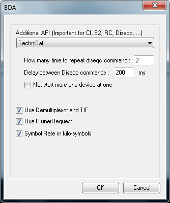

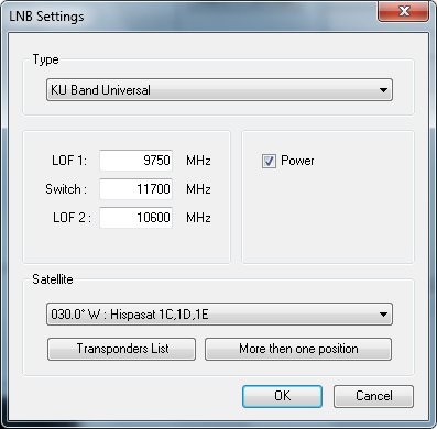

Prog wrote:Settings->Tv Sources->LNB
Also mode in Settings->Device options important for S2.
can you tell me what shoud I set?
I think that that should exists some aditional api for technisat s2 cards.
I allready update to version 6.91.01
Thanks in advance
Best Regards
bthk
lnb settings
device options
device options.png (24.32 KiB) Viewed 17031 times

bthk wrote:Hi,
I'm trying to scan dvbs2 transponders on hispasat but no channel are finded.
bthk
for "dvbs2 transponders" needs more level signal. How many are you?
Well in computer the level signal never goes to much higher
in progdvb I get level 21 quality 56% with 0.20% loss and the image is very good
but now I guess I have solved the problem because I think that SkyStar 2 eXpress HD is not DVB-S2 compatible, unless some one confirmes it. On the box it says DVB-S/DVB-S2 but only in english.
My hint is that this is a print mistake. :( I mailed the seller to ask if I can change it for the one compatible.
