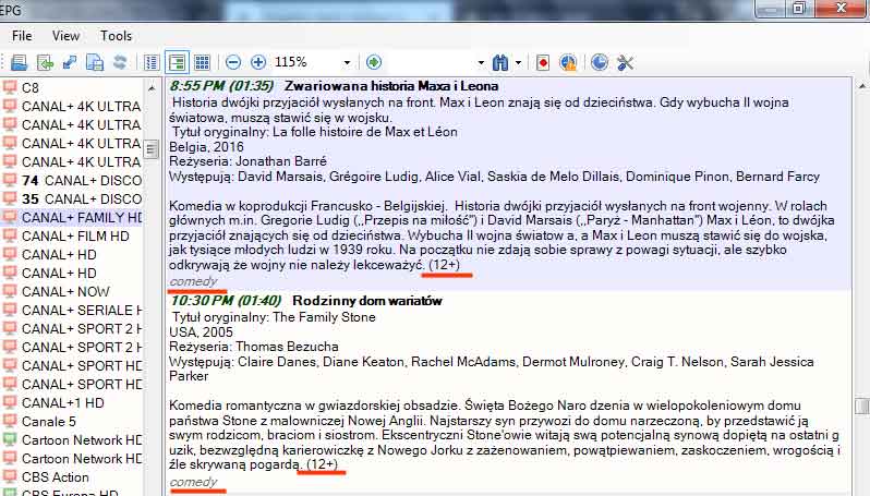

2-
the attached pic is EPG from server side
there is category (comedy) and rating (+12) marked by red line
in client side (iptv client) they are missing for all channels
thanks

2-
thanks
Re: progdvb client channel list and XMLTV
#4Yes, current version not convert addition fields to xmltv. I can add this but not now because very busy in other part of app.
